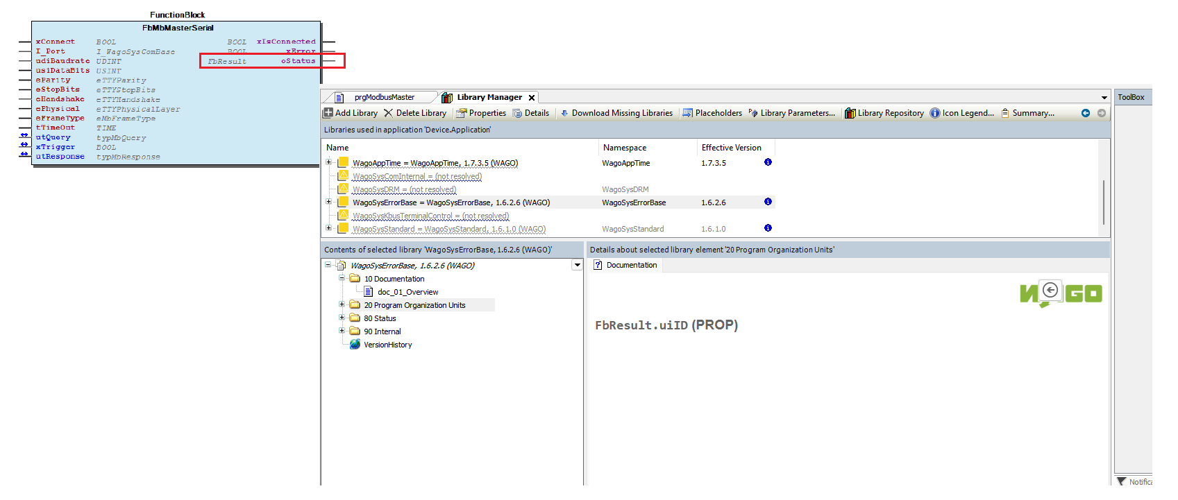

I am not able to Download the documentation file for the libary WagoSysErrorBase . As I need the description for all the properties in the Function of FbReult ..
I don’t understand what kind of problem you have? You have all the description below.
The properties in the FbResult such as eSeverity (Enum ), uiID (Uint) have a certain value which describes a certain condition which is not available on the Library documentation ,

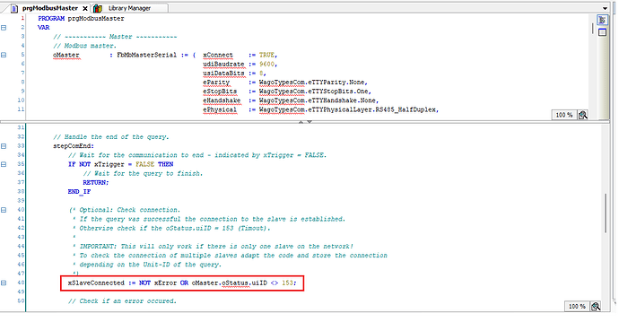

Currently an existing code has a condition which compares the uiID with certain value 153 … Hence if there is a Description file available for understanding other possible values of uiID ..
I understand, I agree that there is no information. I checked in Cocktip and Codesys the information is the same. It is very strange that this variable did not attach a meaning.

eSeverity you will get from WagoTypesCommon.
uID, sDescription etc. has to be implemented by the Functionblock which implements WagoSysErrorBase.
The information you are looking for is described in WagoAppPlcModbus → 80 Status → ErrorModbus
