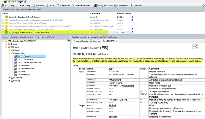

I’ve never worked with the library directly myself, but have you tried XML_Utility_SL? It provides for both directly reading an XML file and reading from a Data Array.
Edit to add: This library is included in the IIoT Libraries SL that can be downloaded from Codesys (not a WAGO library). The license for the IIoT Library suite is included in WAGO controllers so you can just download it, no need to purchase a license.
Is there an easy way to update a library? I have 1.9.0.0 and it comes with zero documentation
I suggest downloading the latest package from the Codesys store. It will install the most recent library versions to your repository.
