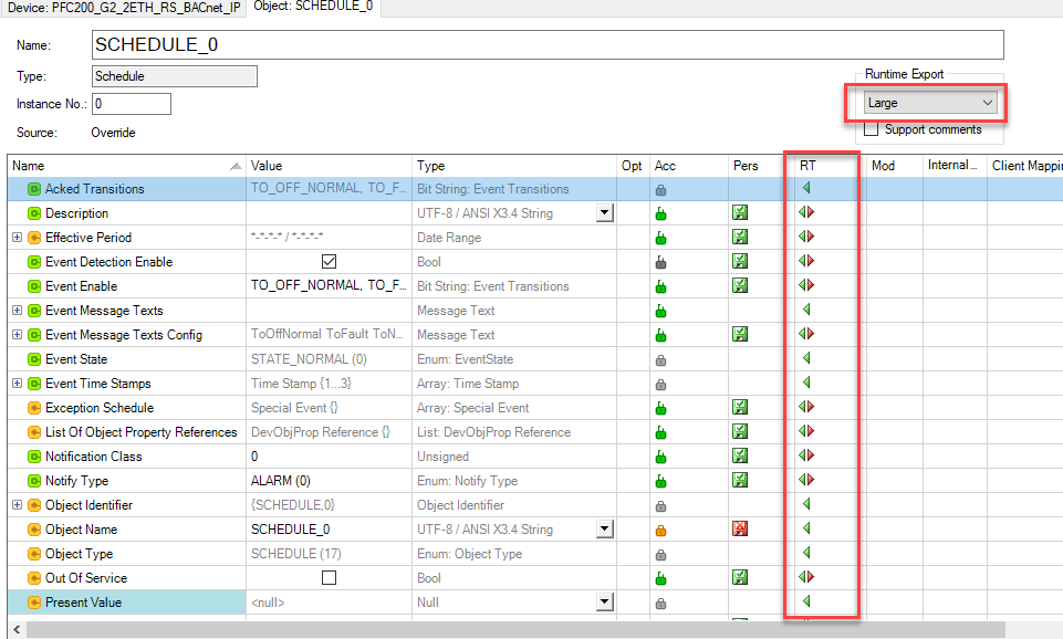

I’ll assume you are using the steps outlined in the HowTo for adding BACnet network objects to your project, including setting up a Client Mapping to your external control setpoint.
I’m not very familiar with the details of the Scheduler object you need, but looking at BACnet Configurator I can see that the “small” version of the object only has one writeable property - Out of Service. I suggest changing to either the “medium” or “large” version of the Scheduler object. This opens up lots of other properties with read and write access.

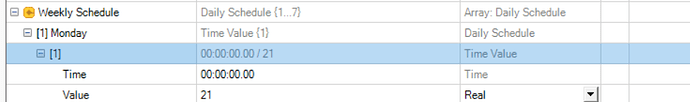

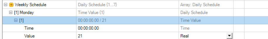

I would like writting temperature value in specific day and time. I notice that in my schedule object occurs Weekly Shedule:
At the BACnet configurator level, I can change the value for a specific entry. Is it possible to map the Weekly Schedule object to another object located in the PFC and then manipulate this object? Would this be a good way to add or edit entries in the schedule, or are there other possibilities for manipulating values in a BACnet schedule?
Through this line I Can add entry to the schedule in monday.
test := BACnetScheduleObjects.XX_sch_200.IWeeklySchedule.IMonday.addDailyScheduleReal(todTime:= TOD#20:51:00, rValue:= 32);
I notice this new entry in bacnet configurator level but it is not should possible because WeeklySchedule properties is probably read only.
WeeklySchedule isn’t read only, it allows read/write access. I think your method above should work.
I didn’t try adding a new DailySchedule, but I was able to successfully read and write a REAL value (like you show in your screenshot above) like this:
So I think the addDailyScheduleReal() method should work like you want.
