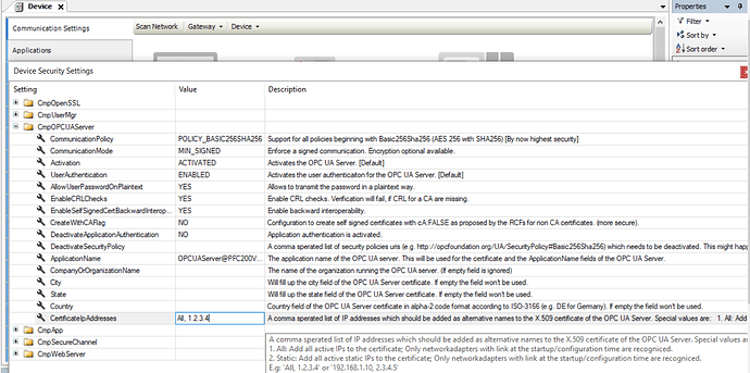

do you work with the IP address or hostname? If you are working with the hostname, you also need to establish the connection accordingly with opc.tcp://PFC200V3-XXXXX and have a DNS resolution. If you are working with the IP address, you would need to make settings for encrypted communication. By default, without setting up, you need a connection via the hostname. A DNS resolution is then required in the network.
Setting at CODESYS:
After adjusting the settings, I would create the certificates again.

the feature/setting is new. CODESYS probably hasn’t updated the help for this yet. Previously, encrypted communication could only be done with the hostname.
