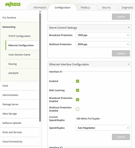

Did you try broadcast protection function in firewall settings in WBM? Or is it important for you to restart PLC?
I didn’t found a broadcast protection function on the firewall page from WBM of 750-8210 (FW29). I don’t want to restart or Power off my PLCs :). This is the only solution i found to solve the problem after the end of a broadcast storm.
Hello, depending on the Firmware it may have changed place, here is for the FW28 on a PFC300:
On PFC200, FW28, i do not have this function :frowning:
Unfortunately, 4 Ethernet ports version of PFC200 (750-8210, 750-8211, 750-8215) use a different component for Ethernet interface and doesn’t support this function.
