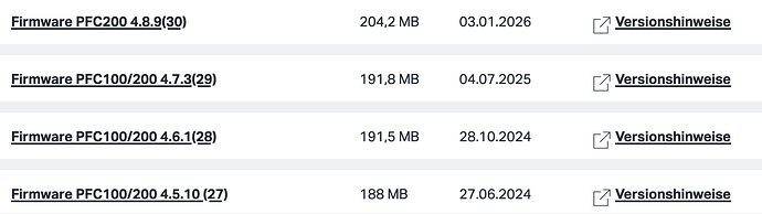

I would like to know what options are available to keep the system up to date independently of the official firmware updates.
Currently, firmware updates are released at longer intervals, sometimes spanning several months:
