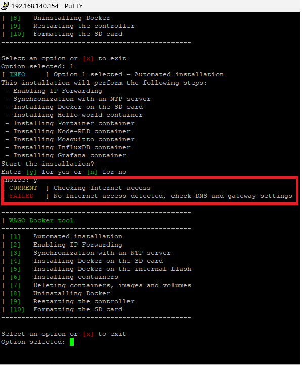

Installation issues with Docker and containers
Despite a working ping via SSH, I am unable to start the installation of Docker and containers.
SSH response: no internet.
Do you have any idea about the configuration that might be missing in WBM?
IP forwarding through interfaces is enabled, and the gateway is declared.
Did you remember to configure a DNS Server in the WBM? And if so, can you verify it is working by pinging www.google.com instead of 8.8.8.8?
