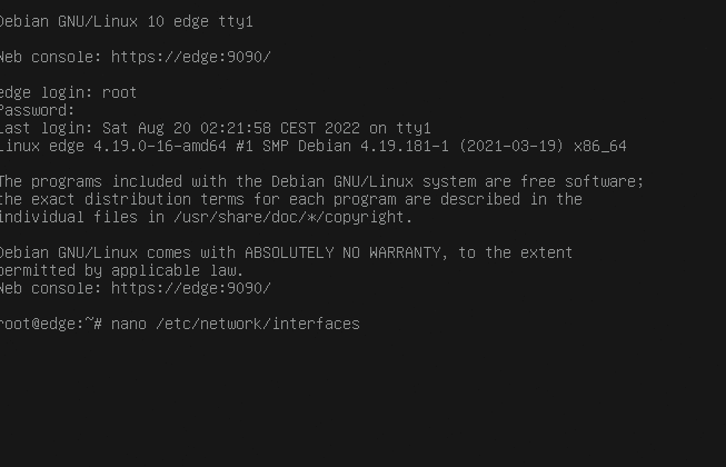

Using a keyboard and monitor attached to the Edge Computer, you will be prompted to log in (root/wago). Because networking is not configured, ssh will not be possible to do these steps initially. You will be prompted to change the default password at the first log in.
- type:
nano /etc/network/interfaces
