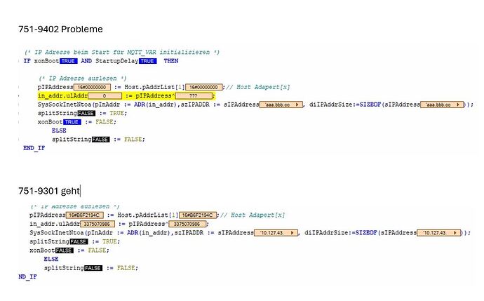

I have a 751-9402 here with FW 30, and it hangs or crashes at a specific part of the program.
The same program runs without issues on a CC100 751-9301 with FW 28 and FW 30.
Does anyone have an idea how I can read out the IP address?
Thanks,
Christoph
Hi, check value in Host.pAddrList[0].
May be you have only one Eth.
And add checks for NULL pointers everywhere..
I was able to get the code to function properly on my CC100 751-9402 on FW30. I had to also use the SysSockGetHostName and SysSockGetHostByName functions for the pointers to function correctly. Without those I got the same exceptions.
