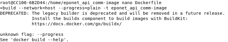

Actually, I would like to report a bug regarding the latest firmware for the CC100:
CC100_V040809_30
I am currently trying to build a Docker container on the controller. It works fine on my PC, but when I attempt the same via SSH on the controller, I receive the following error message:
If this is indeed the case, I would expect that the firmware includes buildx by default.
It would be great if I could build the containers directly on the controller. This would save the hassle of transferring pre-built Docker images and specifying specific paths for execution. Is there any way for a user to install buildx on the CC100?
Thank you in advance!
Louis
The docker build is possible on the target itself.
The error is related to the argument --progress.
Try without this parameter, it should work.
