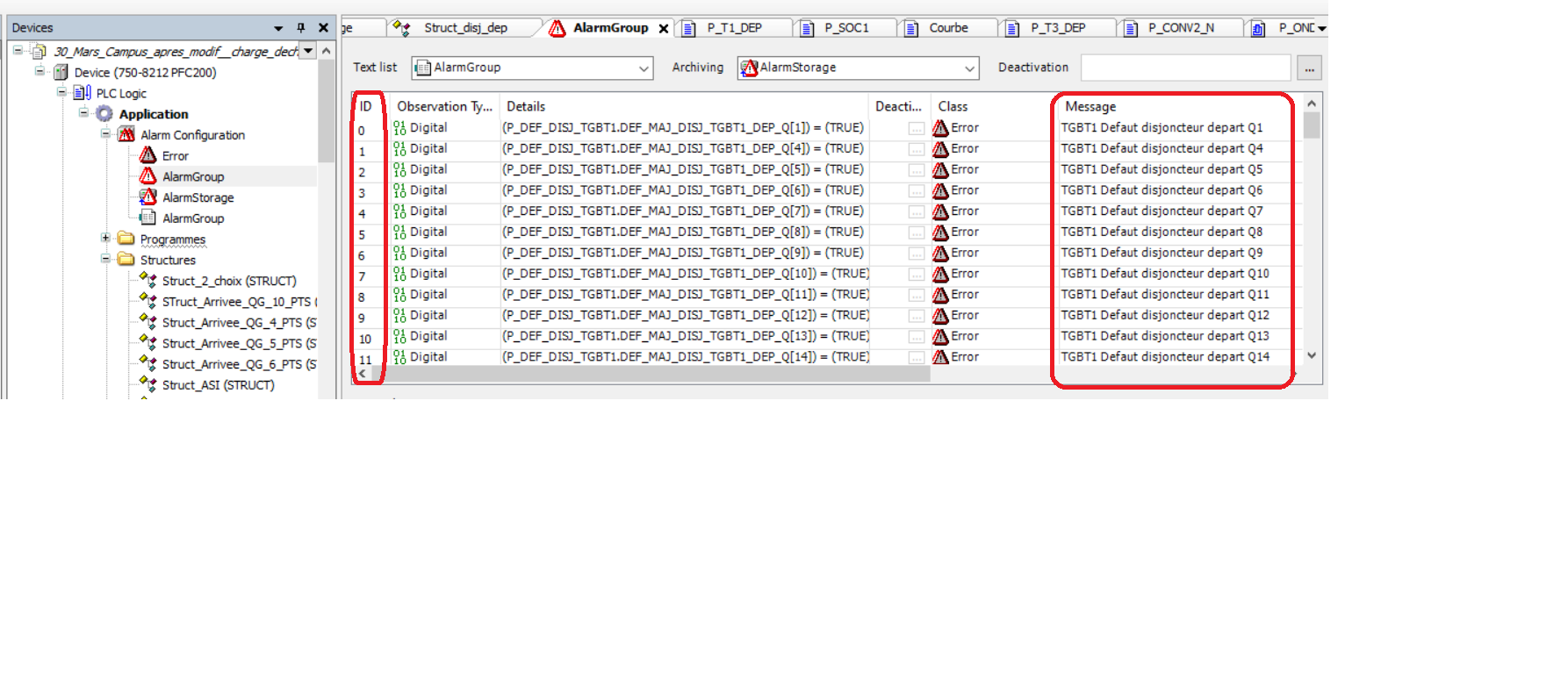

It should be fine if wago had already developped a program, that can take the ID number of the alarm manager inside in is function, to send sms or email.
I’ve made a program to read the alarm manager data and do something if needed.
what would you need to do ?
Instead of declare a text message for each alarm you want to send by email or sms , why not using the ID number of each alarm in Alarm group as a sort of reference , to pickup the Alarm Message ?
ex: TGBT1 Defaut disjoncteur depart Q1 for ID 0 in the following example . I don’t know if it’s possible to do it , and how to do it , but it would save a lot of time.
This function reads all information from the Alarm Manager in case of an active alarm;
