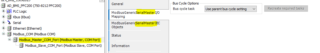

Hi,
is the red marked variable mapped to your TestSignal variable?
TestSignal is declared as WORD and the mapped variable is declared as ARRAY [0..0] of WORD. You have to map the variable in the second line where type is word.
Then you have to use the variable in the program also.

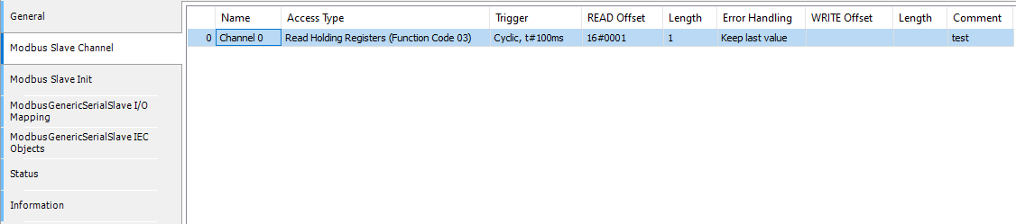

Can you do a screenshot of the slave “General”, “Canal serveur Modbus”, “Init serveur Modbus”.

For the start address in the canal server I set to 16#C550 because of the documentation of the meter I use : MODBUS tables of Countis_E43

Can you try in the variable, instead of linking a variable from the project, declare a variable in the “ModbusGenericSerialServer Mappage E/S” and call this variable in your program.
