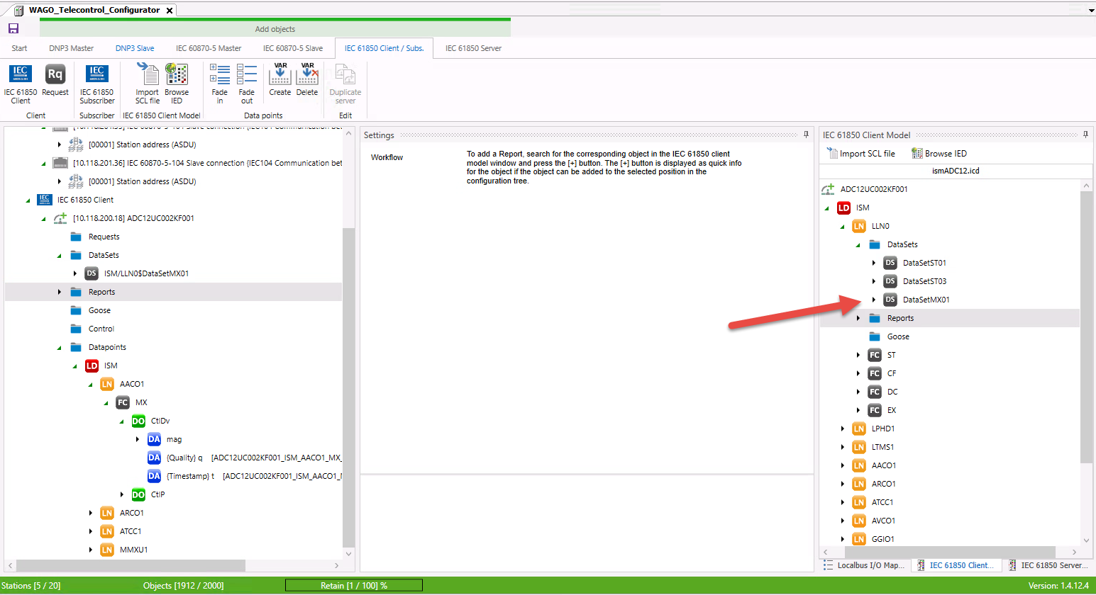

I am using the WAGO PFC200 controller (750-8212/0025-0002) with firmware version 04.05.10(27) and programming in CODESYS 3.5 SP19 Patch 7. I am configuring an IEC 61850 client in the WAGO Telecontrol Configurator (version 1.4.12.4) and have several questions and concerns regarding the configuration:
Limit of 2000 Tags/Objects:
The configurator appears to have a limit of 2000 tags/objects. Is it possible to increase this limit, for example, by modifying some configuration file? How can I handle cases where I need to configure more tags than this limit allows?
Selecting Tags from DataSets:
When selecting tags to read from a slave, I can only choose entire DataSets without the ability to select individual tags within a DataSet. This results in reading unnecessary tags, which consumes part of the 2000-tag limit. Is there a way to configure only specific tags of interest, bypassing the rest of the DataSet?
Accessing “Settings” (ASG) Type Objects:
The slave’s tag structure includes objects of type “Settings” that require specific values to be written. However, these tags are not included in any DataSets. Is there a way to configure and access these tags?
