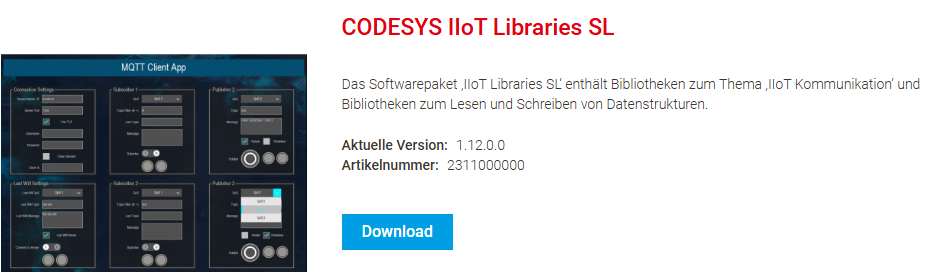

Hello Tomast,
So you can also use the Codesys IIoT Libraries SL, if you use the newest Firmware the license is part of the Wago PFC.
Hi @Michael,
Thx for reply. I will check this one - i tought i needed to pay extra for this license. Does it work on PFC and CC100 or only pfc?
It Works on all Wago PLCs
