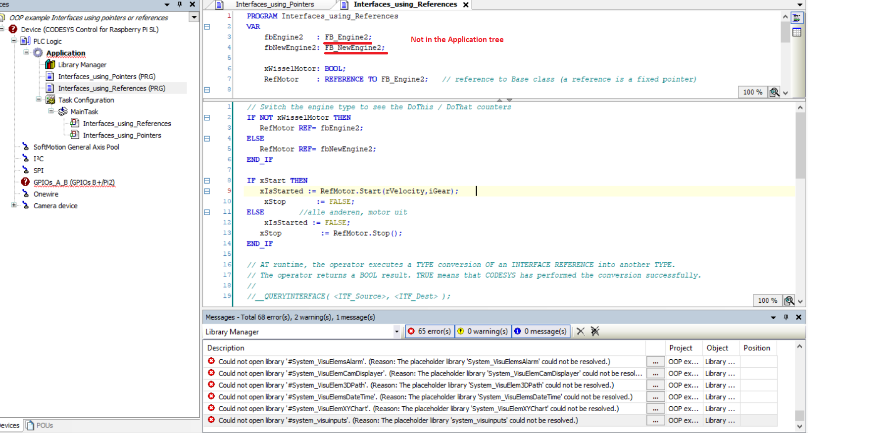

Hello, so i only know those examples from Codesys:
And those one from an GIThub source:
yes that’s right oop-concept codesys V3 github provides programs you can dowload, to be familiar with oop concepts , but the FB ‘s are missing !
have you got any other suggestion ?
you can find them in the POUs (Global project section):
