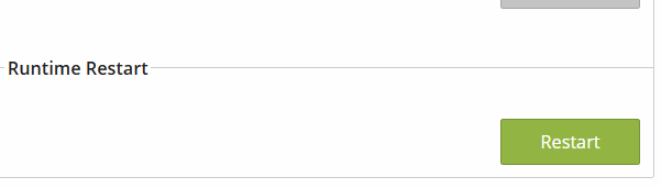

Hi, have you tried restarting the runtime?
Hello, what exactly do you mean by runtime?
In the WBM, in the “Fieldbus” tab → OPC UA → Runtime restart
