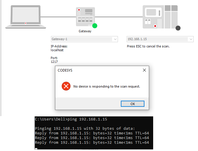

I got new project in hand with wago pfc200 750-8212. PLC version was 3.5 so after 4 hours of loosing connecting i was able to upgrade it to 4+ for codesys V3. But now im facing the wall, network scan shows nothing. I set the runtime version for V3, ping is okay but nothing in codesys, why?
Hi, can u send screenshots please ?
Which FW and which PFC is it ?
Does the firewall (of the PLC) is enabled ?
automatic attribution mode should add the port number after the ip address like 192.168.x.y:”port_number”
