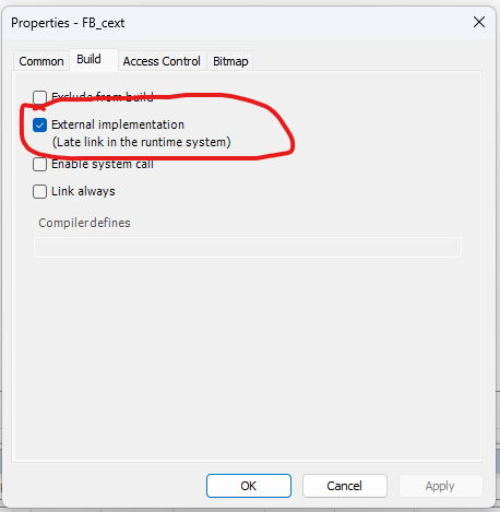

But I hope that with manual firmware building I can extend the firmware and already include in it my custom C module, so it won’t have to be uploaded with Codesys project to PLC. I mean that I will have to only mark FB module as ‘external implementation’

Sorry for second post, but I was unable to paste more than two links. I’m refering to this codesys functionality
