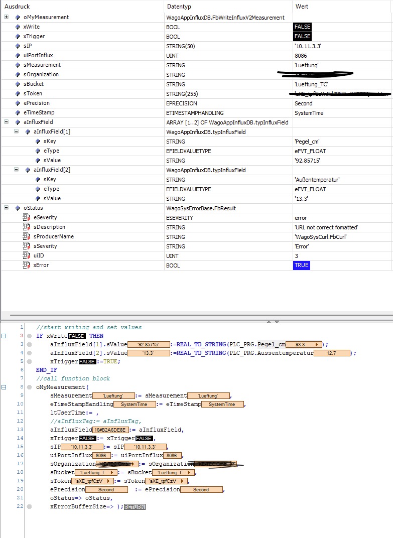

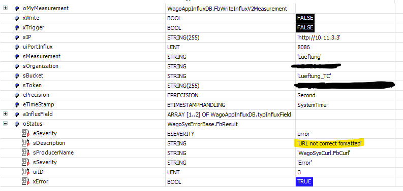

I tried to setup the writing of data from wago plc 8212 to influx db.
I get the error code ‘3’ URL not correct “formatted”. I tried several formats, with and without http/https or the port, but nothing seems to work.
How should the correct format look like? Or are there other possible errors?

Don’t include the “http://” in your IP address string. Just use ‘10.11.3.3’.
Hello Adam,
Thank you for the quick respond. I also tried only the IP adress, but it didn’t work…
Are there other settings i could check?

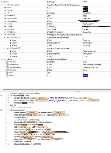

Are you still getting the same error? If so, you may need to send more detailed screenshots showing your exact inputs variables sent to oMyMeasurement.
Yes, the error still appears. Does this information help?
Sorry, I’m not seeing it. The old test program I used in the past seems similar and isn’t giving me that error (I get an expected “failed connect” error because the InfluxDB server no longer exists).
