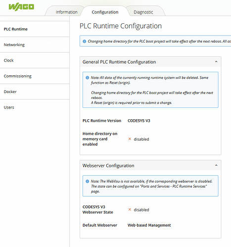

I am currently creating a web visualization for my PFC300 controller. However, I am unable to access it via my browser. The visualization is already running in CODESYS.
The following is displayed in my WBM, but I do not know where to enable it:
My problem is that there is no “Ports and Services” tab.
Did I overlook something, or could someone help me get the web server running?

I believe you have logged into the WBM as a “user” account, which has limited access. Try logging in as “admin” (default password is “wago”), and then you should see the full WBM.
What you are looking for is at the Configuration → Ports and Services → PLC Runtime Services location.
Yes, great.
Thanks. It worked.
