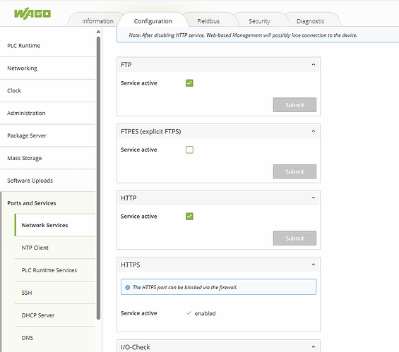

When you say port Open, are you talking as Open in the firewall or as the Service is Running ?
You need this setting

Yes, all ports are ok I think.
For some reason it’s working again but we don’t know why.
The service is running.
