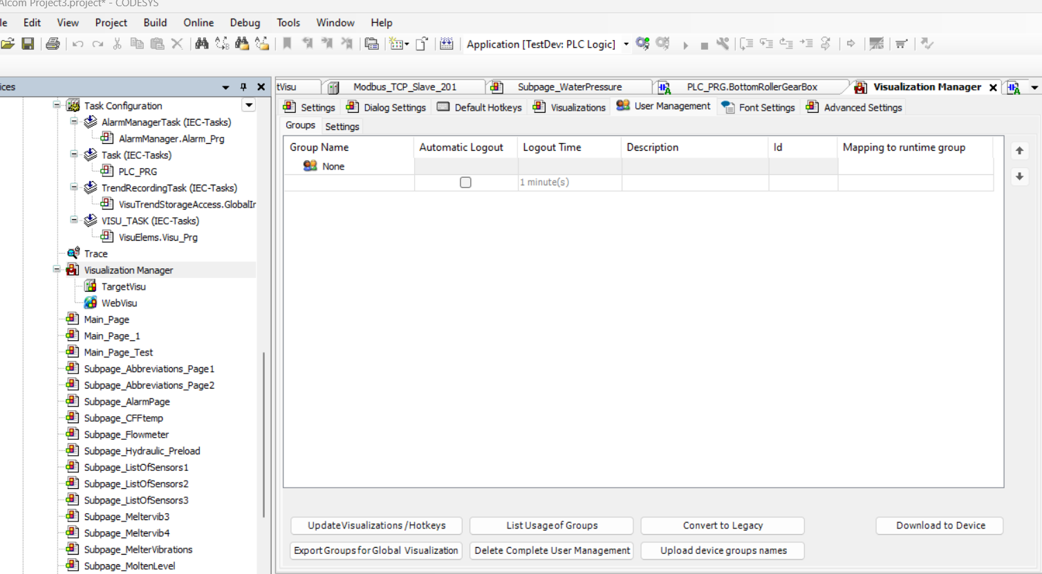

Do you have user managment enabled? in your codesys project click Visualization Manager>User Managment and enable it, use legacy
Where exactly is the enable button?
seens users are already enabled, you just need to click “Convert to legacy” so you can create users in the new tab that will appear
