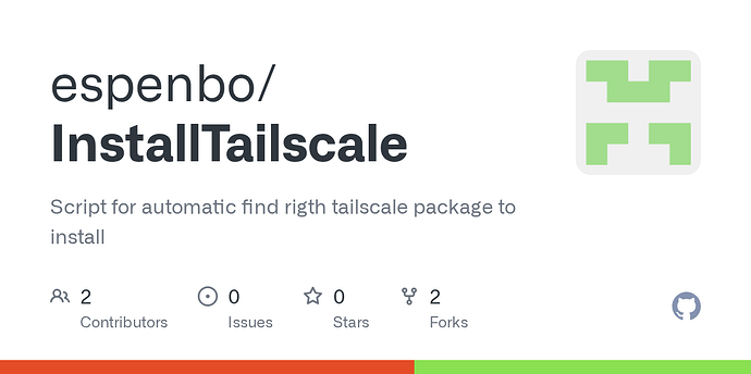

I have started to make a installscript for tailscale.
Please give feedback

Rewrite InstallTailscale.sh: safe atomic upgrades, fix stale static-binary parsing
The Tailscale download page changed its HTML structure ( anchors
became
), which had silently broken both the static-binary
lookup for arm/arm64/386 and the per-distro install-script lookup for amd64.
Rewrote the parsing against the live page.
Also fixes several correctness/safety issues found while validating on real
WAGO PLCs (PFC300, CC100, and a heavily space-constrained Old PFC200 BACnet controller):
  • Never delete the running tailscale/tailscaled until the new binaries are
    downloaded, extracted, and validated (previously deleted eagerly on update).
  • Atomic install with backup + rollback, using an off-destination backup
    location so it doesn’t need double the space on cramped root filesystems.
  • Low-space fallback: when there isn’t room to stage old+new binaries side
    by side, remove the (already backed-up) old binary first and copy the new
    one in directly - only needs headroom for the version-to-version size
    delta, not the full binary.
  • Replace stat -c%s with wc -c: some embedded BusyBox builds ship stat
    without format-string support.
  • Fix a subshell variable-scoping bug that silently prevented the extraction
    directory from ever being cleaned up.
  • New init.d script with PID-file repair, pidof fallback, and a real restart
    path; installed via the same backup+rollback pattern as the binaries.
  • Decouple daemon restart from install, with an optional detached restart so
    it survives the SSH-over-Tailscale session it may itself interrupt.
  • Fix duplicate install-status checks, curl --insecure, and a fetchAndParseData
    argument/scoping mismatch from the previous version.
Bra greier!
