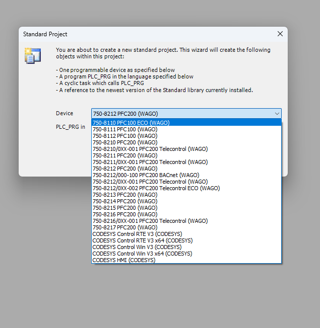

I am having a strange problem with my fresh CodeSys installation:
i’ve installed CodeSys v3.5 SP21 Patch 1 and then Device Description CODESYS 2.0.7.5. Everyth went good but when i want start new project i am getting a list of devices but without CC100 (am using 751-9301). I tried reinstalling everyth but it doesnt help.
That Device Description file was released along with FW29, which currently only supports PFC100 and PFC200. For CC100, you should still be using FW28, Device Description 2.0.6.8, and CODESYS 3.5.19.7.
If you want to stick with SP21-P1, it will probably still work but not all libraries are guaranteed. In this case, I recommend uninstalling DD 2.0.7.5, installing 2.0.6.8, and THEN you can re-install 2.0.7.5, if desired, for PFC support.
Once FW29 is released for CC100, TP600, and PFC300, you can expect a new version of the Device Description to be released along with it.
Hi @AdamReeve, thx for your response,
Now it’s clear but strange with new library all the devices are not included such as 751-9402 or PFC300 (750-8302). I will then continue with older version of codesys where i already have working libraries.
