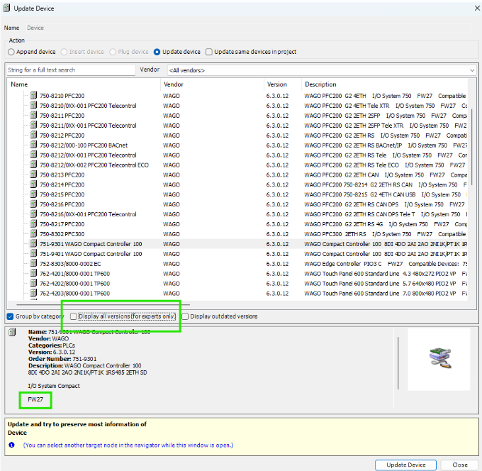

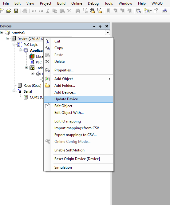

Since FW 27 and FW 28 use the same CODESYS version, you can install both FW 27 and FW 28 device descriptions into SP 19 Patch 7 using the CODESYS Installer.
After both device descriptions have been installed, in the CODESYS software environment, right-click the device (controller) and select “Update Device”.
In the Update Device window, enable the Display all versions option to view all available device descriptions, not just the newest one (FW 28).
Selecting a controller will display its description so you can confirm whether it is for FW 27 or FW 28.
