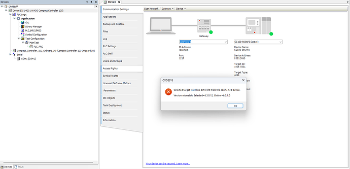

When connecting to a PLC in CODESYS, you may encounter the following error message:
Error: Selected target system is different from the connected device.
Version mismatch: Selected = x.x.x.x, Online = x.x.x.x
This message indicates that the firmware version of the connected PLC does not match the version configured in CODESYS.
How to Resolve:
You have two options to fix this issue:
  1. Update the PLC Firmware
    Load the correct firmware version onto the controller so that it matches the target version selected in CODESYS.
  2. Change the Target Version in CODESYS

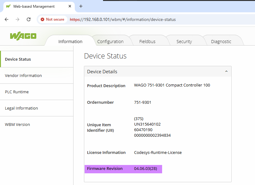

    1. Check the Firmware Version running on the device:
    2. Modify the device configuration in your CODESYS project to match the firmware version currently running on the controller.
