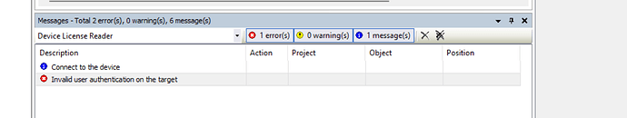

basically i have updated the plc to the correct software version but now when i try and go online and login on codeys it give me this error invalid user authentication on the target. i cant seem to figure out what it is

You are not using the original Wago runtime, but the CODESYS Control for PFC 200 SL runtime from Codesys. This runtime has a different authentication system. With the first login after installing the runtime you had to enter login data.
Check here how to reset the login data.
