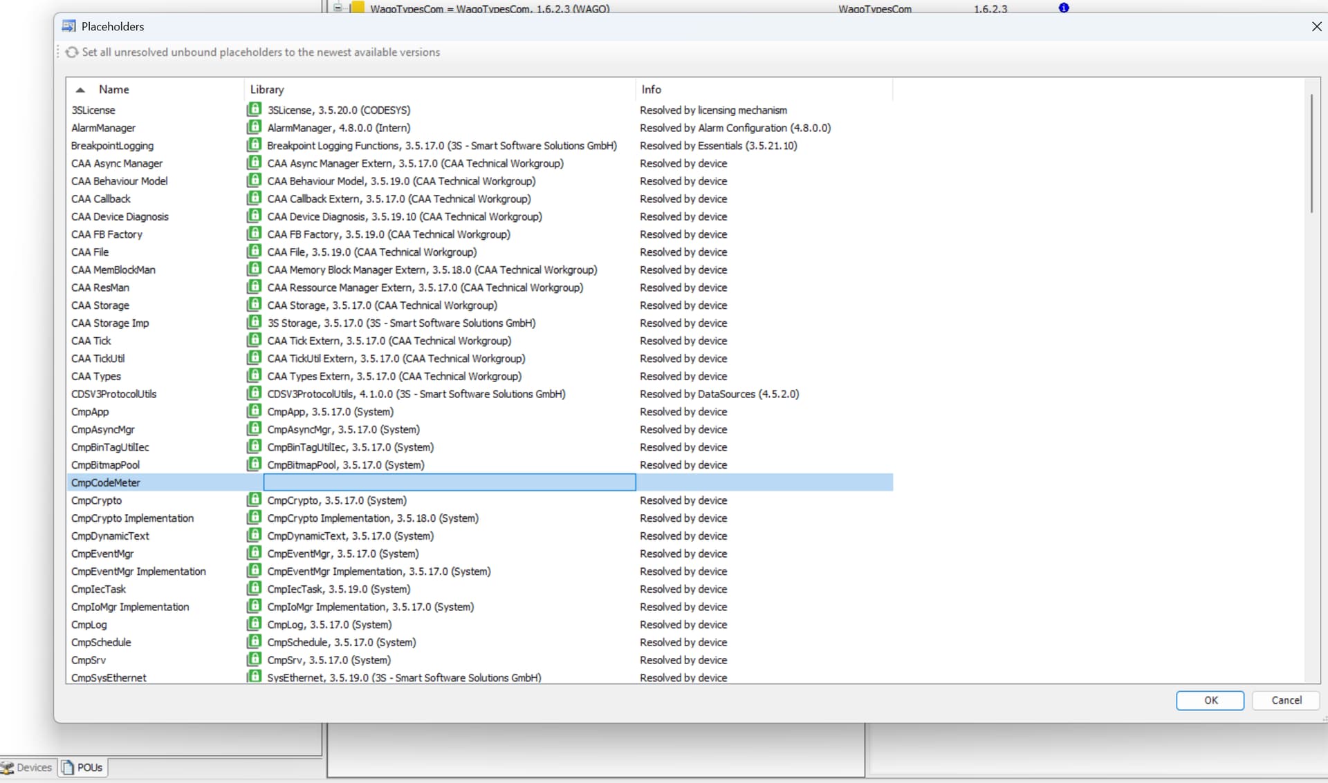

I found workaround of this problem.
How to solve the problem? I am interested to know.
in your application, POUs, library manager → Placeholders set CmpCodeMeter as none (right mouse click on library version and press none)
