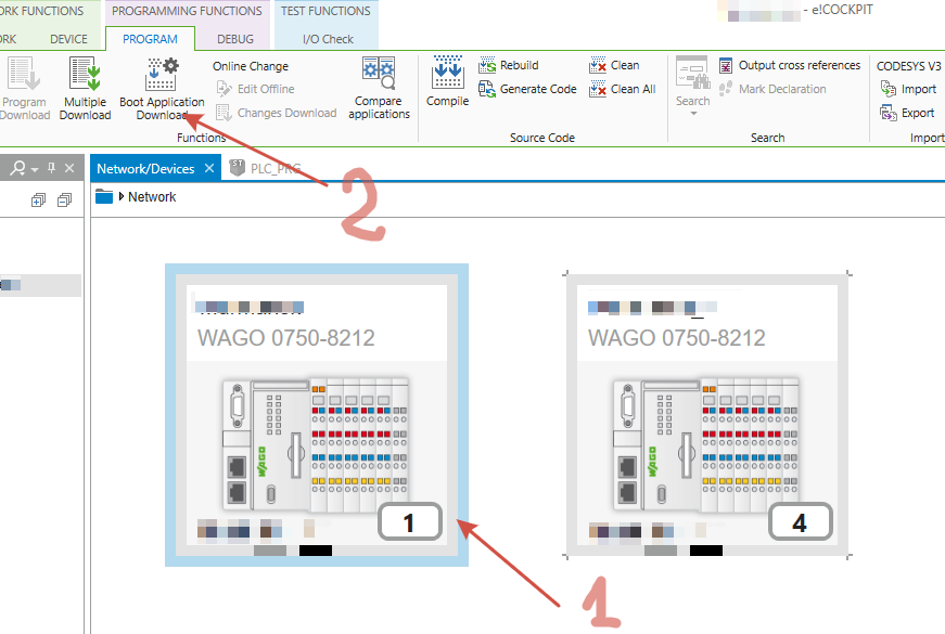

Thanks for a quick reply! I also noticed that there is this line missing in blank controllers. This makes it a bit more difficult if I have a blank controller and would like to just drag and drop files to controller to make it run my program. I found WAGOupload a convenient tool to transfer files to multiple controllers, but it doesn’t have a tool to modify eRuntime.cfg file. Do you know any other easy way to make multiple controllers running the CS/e!C programs without using the IDE?
I understand correctly need to choose a controller in the project and then click on the Boot Application Download ”? The window appears where to save.
