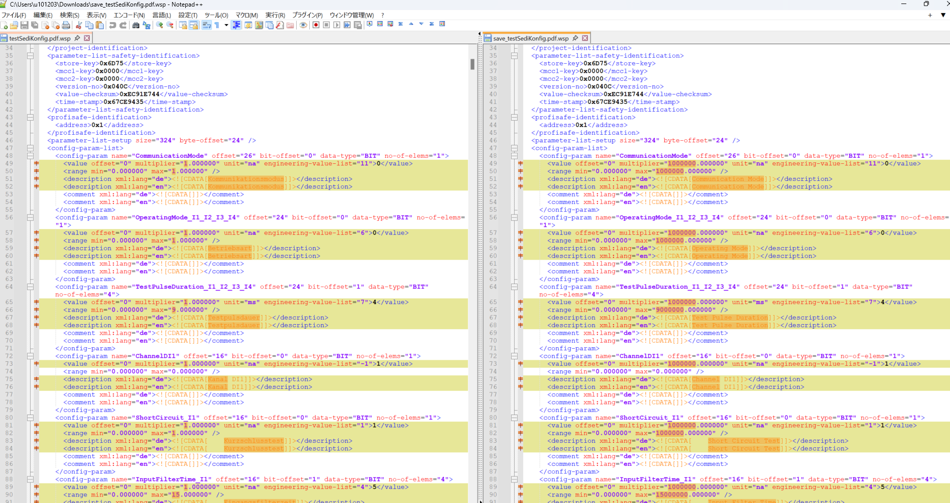

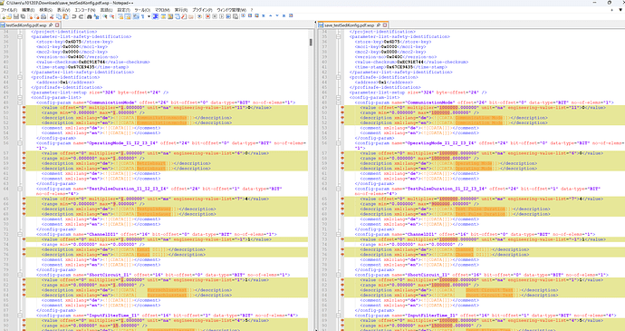

My workaround was to open the XML file(i.e notepad++) and delete all instances of “.000000”, which resolved the error.
I believe this is caused by SEDI automatically appending “.000000” to the saved WSP file.
